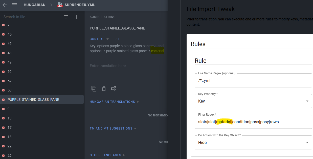

Thanks for the reply. The File Import Tweak app seems to be exactly what I’m looking for, but it looks like the files need to be somehow re-imported for the rule to apply.
Rules are applied to new or updated keys in your resource file in the order they are listed. If a key matches multiple rules, all matching rules are applied.
Only new or updated keys are affected by rules during a file update.
I’m not sure what a “file update” exactly means here, but I tried translating a single entry and saving, nothing changed. I Also tried removing the language from Settings > Languages and adding it back from there, but the rule is still not working. (And just to clarify, yes, I did click on the submit button before re-adding the language and checked “hidden” file filter)

Hello @Roman, thanks it’s working now! There is just one small issue. The RegEx for matching the files seem to only match against the file name itself and not the entire path including the folders. I believe this is not possible right now? It’d be really nice to have this feature.

I think there’s been a misunderstanding. I don’t want to rename/delete any files or replace anything in the files. The File Import Tweak app is what I need, but there’s a problem with the file filter regex that it accepts. The regex that you input for the file filters is only matched against the file name and not the full path. For example, if my file is in /master/core/src/main/resources/guis/item-editor/attributes/something.yml the regex is matched against something.yml string only. I.e. I cannot apply rules to files based on their folder. I.e. If I were to use .*guis.* the regex will not match and the rule will not be applied to something.yml
