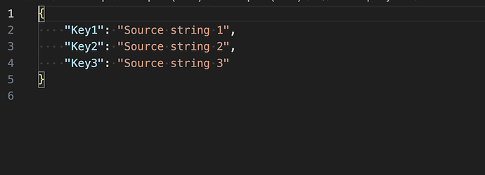

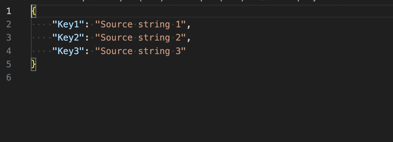

Hi @zly2006 ! nested structure means that file inside has to have nested structure or not. So if you have usual json file it will look like this
and in this case, strings will be trimmed with the option enabled
but if the file inside has a nested structure (here are examples JSON file localization) , then untranslated strings will have empty values
