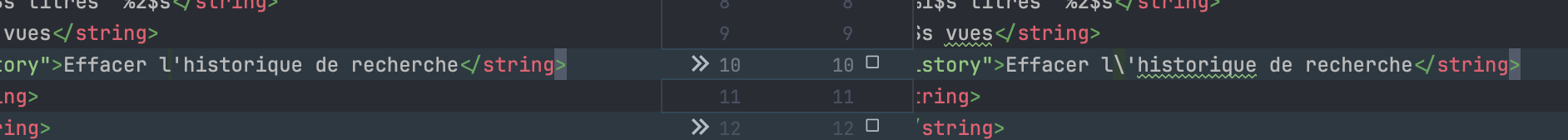

@Dima Hi Dima, thanks for your support, but now my project was upgraded to Compose Multiplatform, and Jetbrains fixed the escape issue, so right now, can you help me to unlink the script in my project? My project id is 613973

Hi, Crowdin still export escape apostrophes in my project :(((

Crowdin plugin in Android Studio still export it for me, my project :)))

Hey @maxrave, it doesn’t seem the mentioned string is located within CDATA. According to specs, apostrophe should be escaped inside Android XML
I’m not certain if it’s a good idea to proceed, but you can set up a custom post-export processor to unescape quotes:

Sorry bro, but new in Compose Multiplatform, we don’t need to escape the ‘ char. They removed this limit of Android Resource
Thanks for the update about the Compose Multiplatform. It looks like it makes a difference from traditional Android resource handling.
To address this, you can set up a custom post-export processor to unescape the apostrophes in your XML files. Have you tried the resources @Andrulko shared previously? Did they work for your case?
