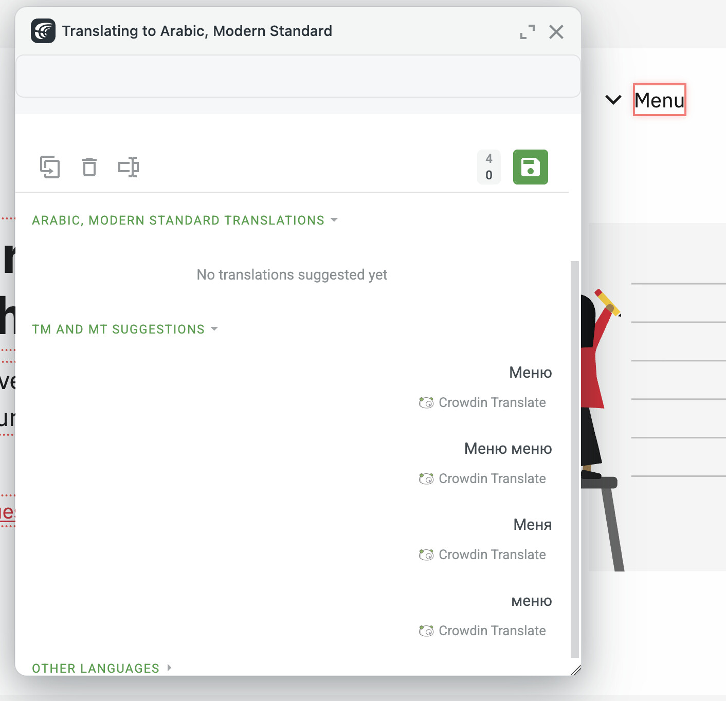

Also, I’ve noticed that we seem to be getting Cyrillic (Russian?) suggestions:
Is this a result of using a custom locale? (We also have one for African French (fr-002) which is correctly picking up French suggestions.)

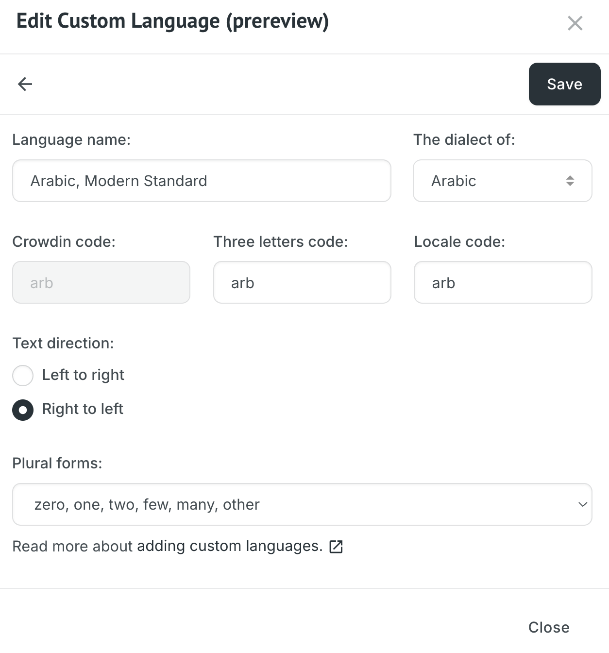

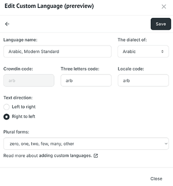

For info, here’s the configuration of our arb locale:

It looks like you’ve put together a clever workaround, but the In-Context editor should ideally handle right-to-left directionality automatically. The unexpected Cyrillic suggestions are also something we’ll want to investigate closely.
