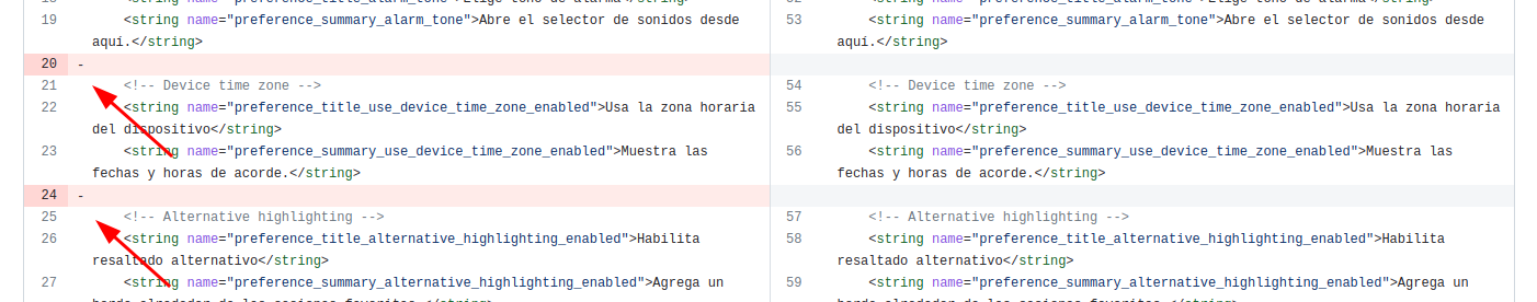

In my Android project I have files with existing translations. I want to add them to Crowdin to extend and update the translation.
The XML files contain empty lines inbetween string resources to better structure the content for human readability.
When I add the files I noticed that empty lines which are present in the file before are removed by Crowdin in the automated pull request as indicated in the screenshot:
Questions
  1. Is the empty lines removal something I can configure, e.g. via crowdin.yml or the web administration interface?
  2. Is the empty lines removal something you are working on to improve?
Crowdin don’t use exactly your file. On the export, the file is, let’s say, rebuilded in order to be 120% valid. As it’s a default parses behaviour, this can’t be changed, unless the code of Crowdin’s parser would be changed.
Probably segmentation will help you but it’s added before file upload, so most likely it may change nothing. Still if you make empty lines to be recognised as comments, it may work.
Still, I’d say accept that diff, it will be one time. Anyway system exports a valid file
