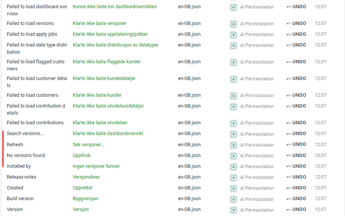

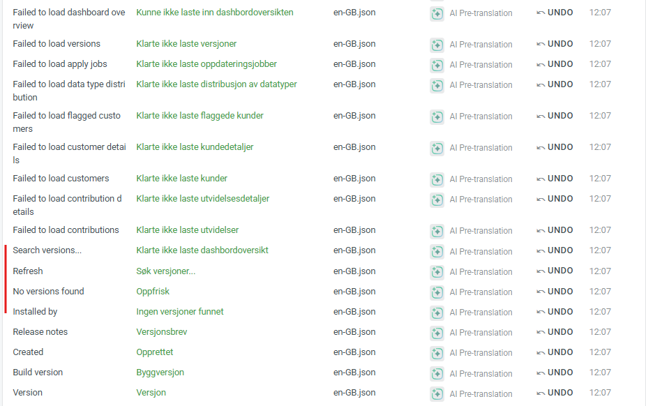

I experienced the same issue. 151 strings were uploaded and the majority of them were translated correctly, but 4 of them appear to have their translations shifted by one position (marked in red).
  • Method: File-level (JSON array sent to AI as a batch)
  • Model: gpt-4o-mini (OpenAI)
  • Batch size: 151 strings in a single call
  • Symptom: Translations shifted by exactly 1 position for a contiguous block of strings
