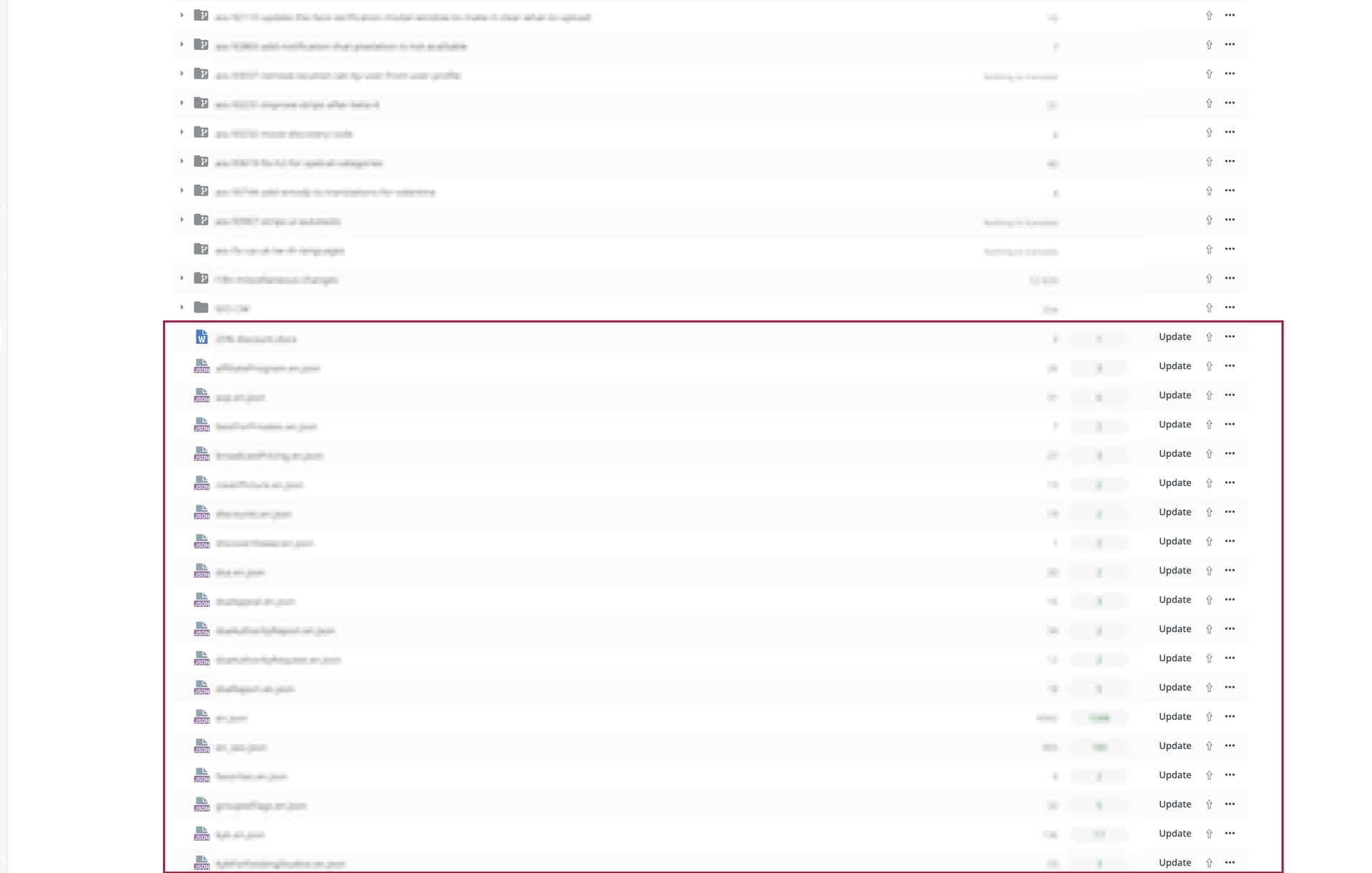

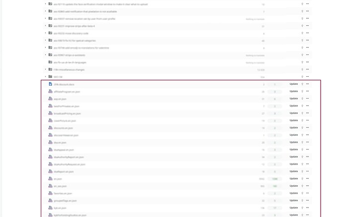

One more question:
Is there a possibility to download not all branches, but only the main translations when using the crowdin download command (without specifying a branch)?
Hi @rabbdroid if the branch is not specified, the system will download all content. If you want to export only one branch, it is necessary to specify what branch exactly you want to have on export
Am I right that you can’t download only main translations that don’t belong to any of the branches?
@rabbdroid I’m afraid no. So it is either branch or all content
