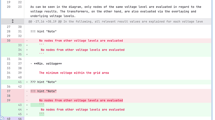

I’m having an issue where indented Markdown text is being reformatted as text fenced in with backticks now, which does not work for our site generator.
Source file:
Exported translation:
(note the indents now being interpreted as a code block and the paragraph fenced with backticks at Line 14 in the export above)
I think this is new Crowdin behavior because it is only happening with recently modified files. This is a problem for us because this isn’t a code block, it’s meant to be an admonition (https://squidfunk.github.io/mkdocs-material/reference/admonitions/#usage - I can’t add more links as a new forum user) (a markdown extension added by mkdocs-material), so this new format doesn’t get rendered properly.
Anything we can do to get the old behavior back?

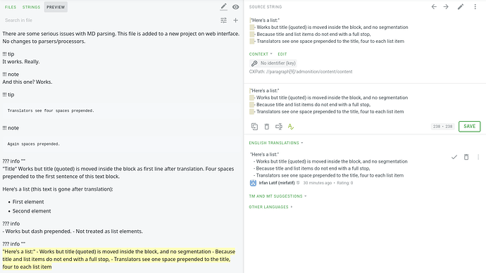

There are some serious issues with MD parsing. This file is added to a new project on web interface. No changes to parsers/processors.
!!! tip
    It works. Really.
!!! note
    And this one? Works.
!!! tip
    Translators see four spaces prepended.
!!! note
    Again spaces prepended.
??? info "Title"
    Works but title (quoted) is moved inside the block as first line after translation. Four spaces prepended to the first sentence of this text block.
Here's a list (this text is gone after translation):
- First element
- Second element
??? info
    - Works but dash prepended.
    - Not treated as list elements.
??? info "Here's a list:"
    - Works but title (quoted) is moved inside the block, and no segmentation
    - Because title and list items do not end with a full stop,
    - Translators see one space prepended to the title, four to each list item

Here are a few more observations.
Source file before uploading:
!!! tip
    It works. Really.
!!! note
!!! tip
!!! note
??? info "Title"
This line is replaced with a blank line when exported. First line after every admonition is removed.
??? info
        - This element is merged with the parent list.
        - And me too.
    - Last element.
Some text.
!!! note
    Part before *"this asterisk:"* is removed.
Some text.
- First element
- Second element details:
    My indentation is deceased to 2 from 4.
1. First element
2. Second element details:
    My indentation is deceased to 3 from 4.
Diff with exported translation:
@@ -1,47 +1,49 @@
 !!! tip
     It works. Really.
 !!! note
 !!! tip
 !!! note
-??? info "Title"
+??? info ""
+    "Title"
-This line is replaced with a blank line when exported. First line after every admonition is removed.
 ??? info
-        - This element is merged with the parent list.
-        - And me too.
+    - This element is merged with the parent list.
+    - And me too.
     - Last element.
-Some text.
-??? info "Here's a list:"
+??? info ""
+    "Here's a list:"
 !!! note
-    Part before *"this asterisk:"* is removed.
+    \* is removed.
-Some text.
 - First element
-    My indentation is deceased to 2 from 4.
+  My indentation is deceased to 2 from 4.
 1. First element
-    My indentation is deceased to 3 from 4.
+   My indentation is deceased to 3 from 4.

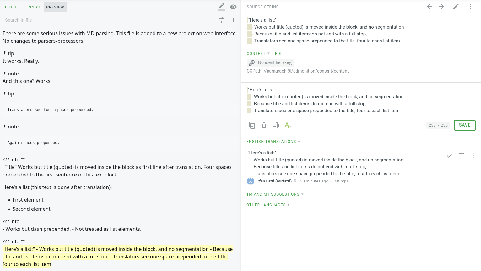

Some issues still persist.
Original file:
??? info
    - Works but editor shows dash prepended.
    - Which means these lines are not treated as list elements.
    - Translators can remove the dash, hence breaking the list.
    - Details:
        - And me too.
    - Last element.
Some text.
    - Works but editor shows no segmentation
Some text.
- First element
    My indentation is deceased to 2 from 4 after translation.
    More detail.
1. First element
    More detail.
Diff with translation:
@@ -1,28 +1,28 @@
 ??? info
-    - Translators can remove the dash, hence breaking the list.
+    Translators can remove the dash, hence breaking the list.
     - Details:
         - And me too.
     - Last element.
 Some text.
 Some text.
 - First element
-    My indentation is deceased to 2 from 4 after translation.
-    More detail.
+  My indentation is deceased to 2 from 4 after translation.
+  More detail.
 1. First element
-    More detail.
+   More detail.
Editor screenshots:
