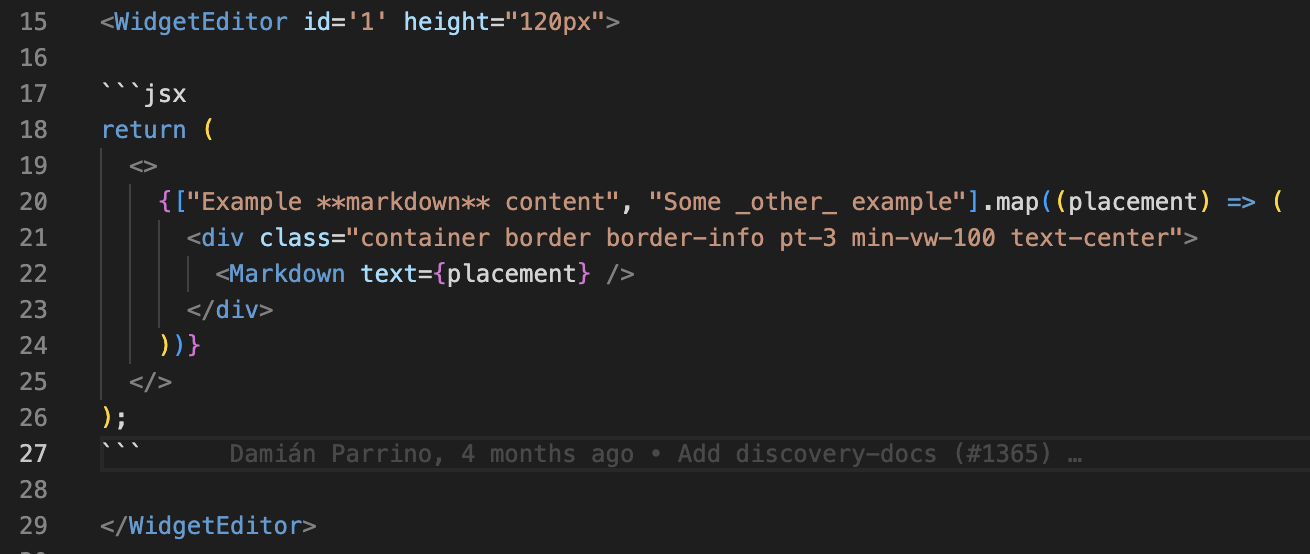

We noticed one issue in the generated file by Crowdin.
In the source file (English), we have the below code blocks:
The part is not touched in the translation and kept as it is. But in the translated markdown file, the code blocks are missing somehow, and only markups are left.
<WidgetEditor id='1' height="120px">
      <div class="container border border-info pt-3 min-vw-100 text-center">
        <Markdown text={placement} />
      </div>
</WidgetEditor>
We think this is a Crowdin bug, and want to know whether there’s one way to workaround this issue.

So, just for confirmation, having “export only approved translation” turned off doesn’t change anything? By default only “save context information” is turned on, can you kindly do a test with “export only approved translation” unchecked?
Yeah. I have tried disabling “export only approved translation”, but it doesn’t work.
The exported file is the same.
      </div>
</WidgetEditor>
