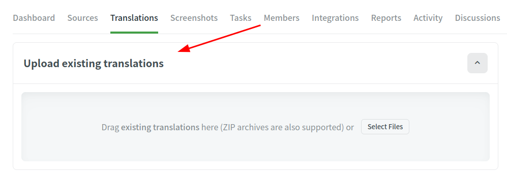

Additionally, I uploaded existing Spanish translation via the web interface:

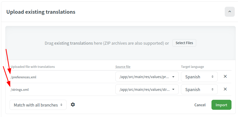

Upload scenario 1 (individual files)
The issue seems to be that the upload form does not recognize the Spanish source folder when I pick individual files:

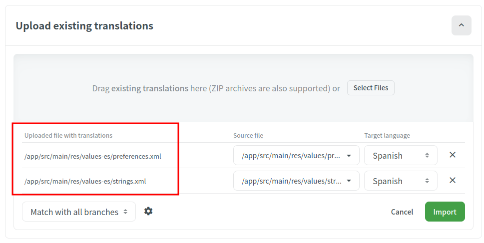

Upload scenario 2 (ZIP with folder structure)
When manually recreate the folder structure, put the folders and files in a ZIP archive, then it looks better:
