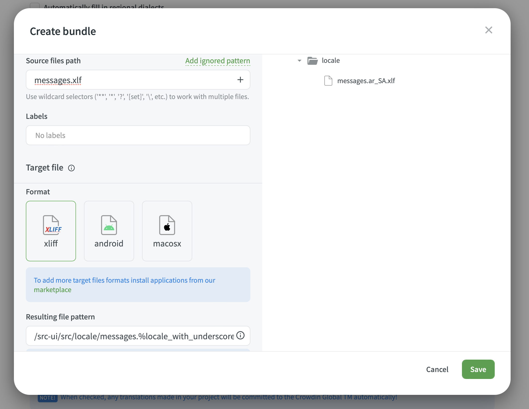

Hi, I’ve re-created the issue. I setup a new project and added my messages.xlf file, then I setup a ‘bundle’ “Test” similar to my real project where the output file is /src-ui/src/locale/messages.%locale_with_underscore%.xlf and now when I download that bundle I get messages.ar_SA.xlf
Annoyingly this will only let me put one screenshot in my post, this is probably the most relevant one:
