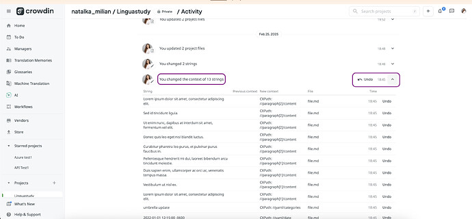

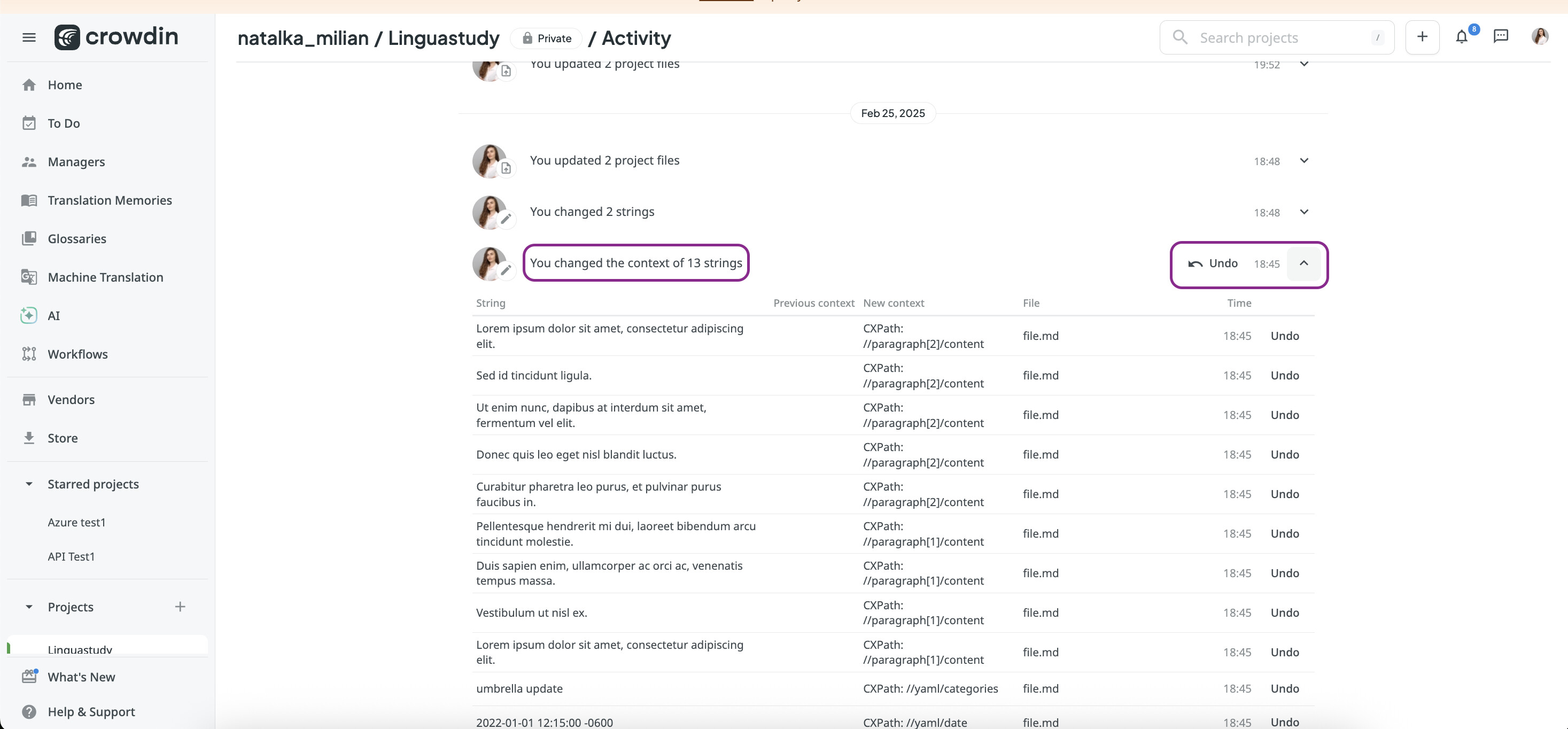

Hi @Dima, thank you for the recommendations. We went for the approach #1 and just mapping x-locations into description field, however, I see that in some cases when uploading new source strings using CLI, the context is not updated.
I believe this happens if I manually edit the context of a string and then try to upload a new context, the manually inputed context is not overriden. However, when uploading a new context for an “untouched” string, the context is overriden as expected.
Seems like there is no way to make the string with manually inputed context be reset back to default state to allow the context to be overriden with one from uploaded source file.
How to do that?
@Natalia, thanks for your answer, but this does not help with the issue.
Even though I can rollback the context, the behavior is implicit. Please allow resetting the state manually without having to look though all of the logs.

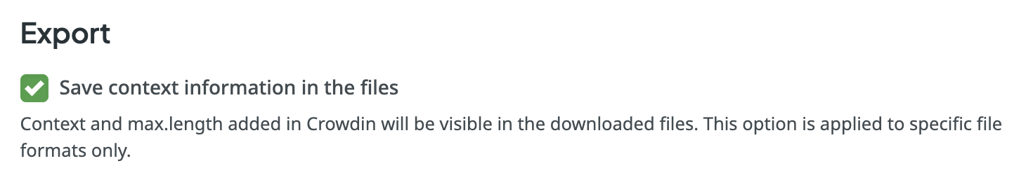

Hello! I decided to drop a reply here as well since other users might be interested.
This is not a bug, but an intentionally added feature. We have a ‘Context edited manually’ internal checkbox (under the hood) to prevent overwriting during an update if someone has manually changed it.
To make it work as you expect, you need to enable the save context information in files checkbox in the project settings:
Thanks,
The checkbox is checked, but still when pushing new source strings, manually edited contexts are not overridden.
The issue is about importing source strings and not exporting, so I don’t get it, how does the checkbox in “Export” settings affect import (file upload using CLI)?
Sorry for the confusion! Currently, if the context is edited in Crowdin, it cannot be changed during the update unless you change the source string as well. So, if during the update you change both the source text and context, it will get updated in the project.
