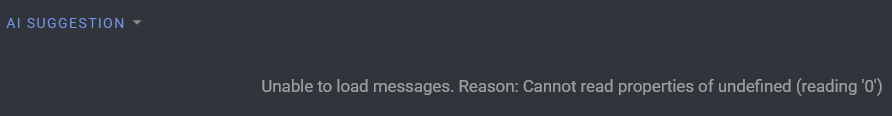

I’ve configured openrouter integration and validated that credentials work. Created default prompts for all three contexts (pre-translate, qa, editor). But when I actually open an interactive translation UI, it tries to fetch AI suggestion and fails with “unable to load messages” error:
I do not see any related activity on openrouter activity page. What might be the problem and how can I get more diagnostic error details than that?

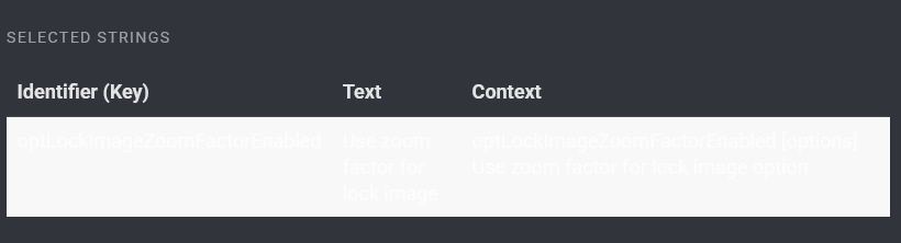

The problem is not with balance. Crowdin fails to even place a request to openrouter. Looking at AI assistant context, it fails to load any strings, which matches the error that I posted above:
