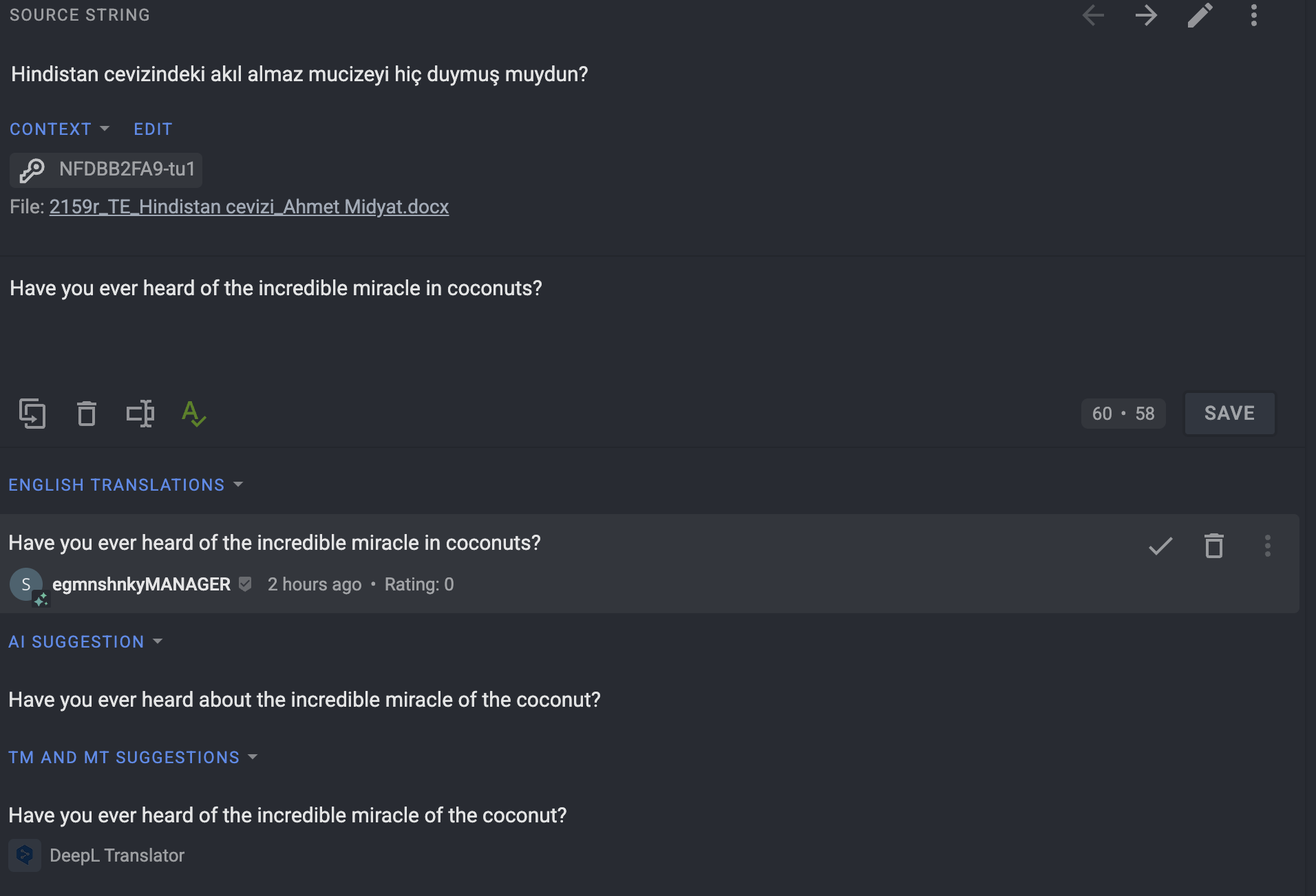

As you can see, there’s no suggestion from proofreading agent

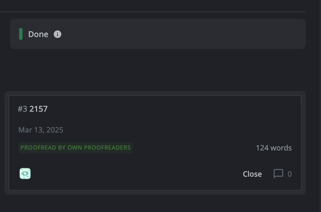

I’ve assigned the project already as you can see the AI Proofreading agent’s amblem on the left bottom.
It automatically switched the task to ‘‘done’’, but when I opened it, I couln’t see any suggestion from AI in any strings
