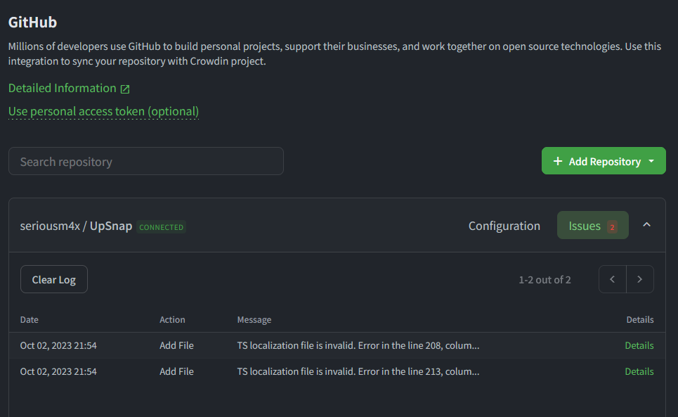

I just set up my first project and activated the Github integration. The sync failed with the following message:
Response:
TS localization file is invalid. Error in the line 208, column 2
This is the file: https://github.com/seriousm4x/UpSnap/blob/master/frontend/src/lib/i18n/en-US/index.ts
It fails because of satisfies BaseTranslation but that is valid typescript. Is there any workaround or some settings that will help with this?

Hey,
no that message is from the project integrations page on crowdin. I can’t import the file. It shows the issue on importing.

Hi there!
Just got some updates from our tech team and we’ve created the task CN-41926 for them to improve the TS parser as it doesn’t recognize the construction } satisfies BaseTranslation;
